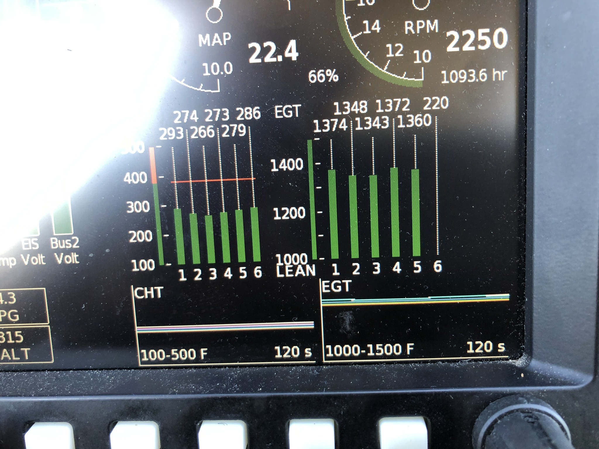

However, I’ve attached 2 photos:
1) The first shows a cruising situation with the EGT set to display changes relative to a point in time. Cylinder 6 ‘1F’ appears to work normally.
2) The second shows the same cruising situation with EGT set to display the actual temperature. Here one can see that
Cylinder 6 displays a temp ‘220F’ that is impossibly low.
Any comments welcomed.

The normalize mode just shows how the CHT has changed since the mode was first selected. Evidently #6 was at 219, it’s now at 220, so it’s changed one degree. Most likely a new probe is needed; they live a hard life.
