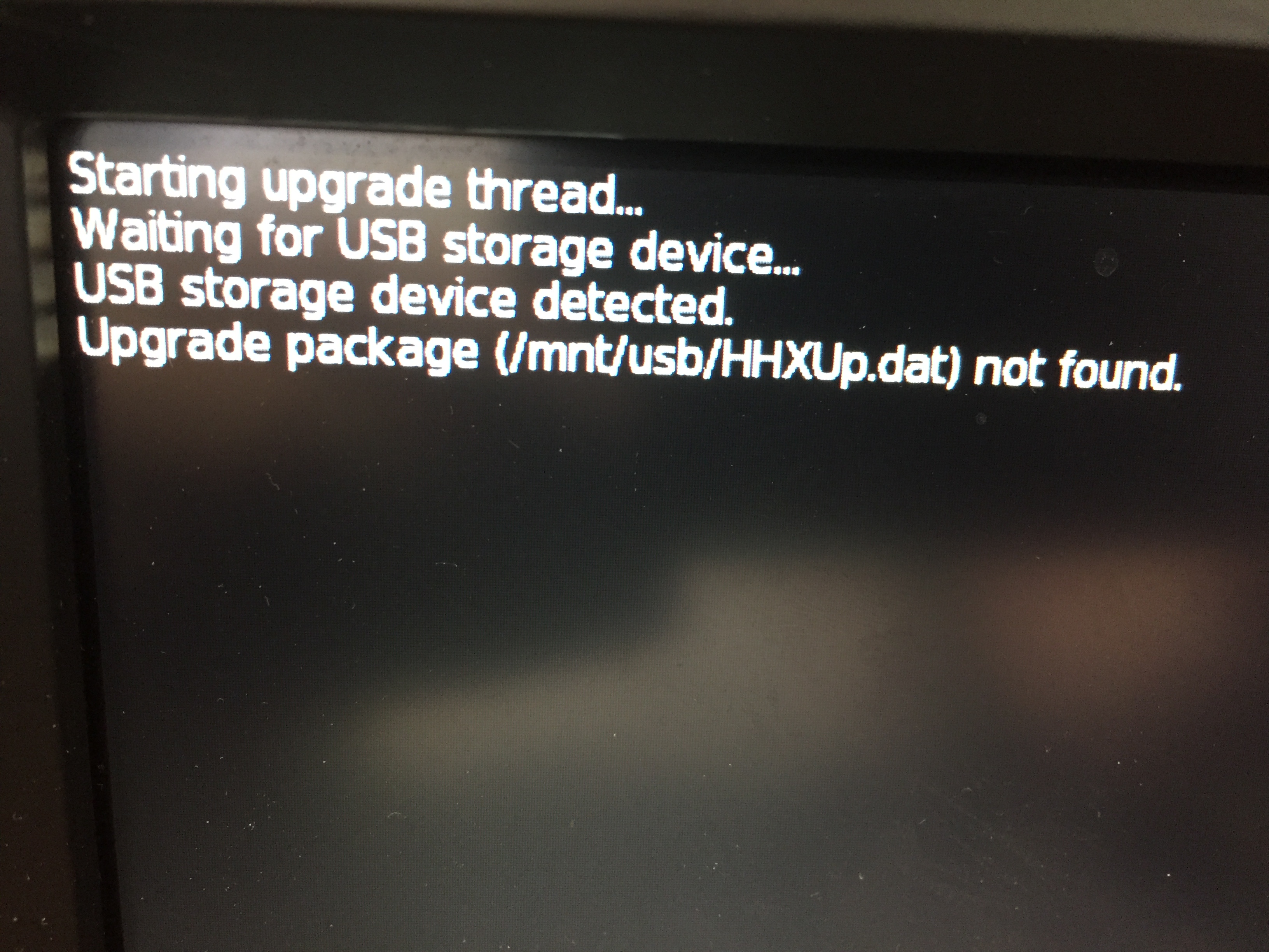

HX screen
HX screen
HXI have an RV-8 with a WS EFIS and a HX EFIS. I want to GRT site and downloaded NAV data onto USB stick using my MacBook Air. When I attemp to load on my GRT's I get failure messages. I will attach the messages.

You may be following an old document. The pictures show the update screen for the main display software, which hasn't been used to update the navigation database in many years. To improve the update process we split the software and database update functions into two separate functions on all of our EFIS models.
The Navigation Database is updated by going to the SET MENU, Display Unit Maintenance, Database Maintenance page and activating the Load Navigation Database function.
