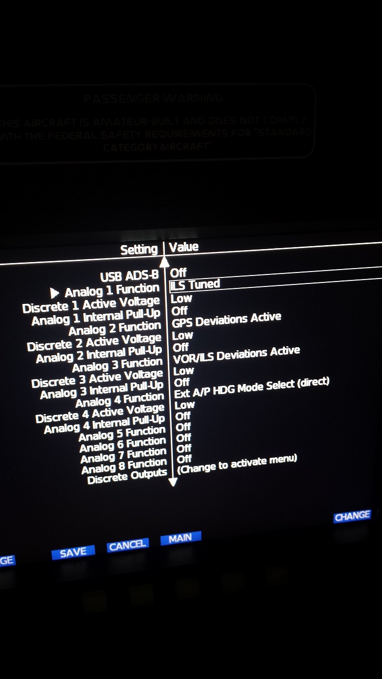

Testing out my newly installed GRT Autopilot with Horizon HX EFIS (V9 software.) GNAV works flawlessly (both on the ground and in the air.)
The problem I have is this: I was ground testing yesterday and could not get the HDG mode engaged. When I activate the A/P in HDG mode, it appears to briefly go in to HDG mode and then immediately switch to GNAV or ENAV. Every time.

After additional testing, I was able to determine that I can't select HDG mode when GPS2 (the internal GPS) is active.
After powering up the EFIS, the A/P will be in HDG mode until the internal GPS activates. At that point it will switch to ENAV mode and stay there.

A little more background on the EFIS set up: The panel has three EFIS. From left to right, they are labelled DU2, DU1, DU3. The A/P servos are connected to Serial 8 of DU2 (the left most unit) and only to that unit.
Some operational aspects of the system seem strange:
1. DU1 and DU3 can display the A/P menu, however they can't engage the A/P. Engaging the A/P can only be done from DU2.
2. When invoking the A/P from the soft keys, the "LAT A/P" softkey is only displayed on DU1. DU2 and DU3 only show the "VERT A/P" softkey. See this video: https://www.dropbox.com/s/u798e1nr9os4n ... y.mp4?dl=0

Check the Analog # Function settings in SET MENU, General Setup, after the serial ports. The screen that's missing the LAT A/P button probably has an analog function set to "Ext A/P HDG Mode Select (direct)". Change it to Off.
Re: A/P will not switch to HDG mode when internal GPS is act
Hi Jeff... I finally got to the hangar this past weekend and you were spot on.
According to the wiring diagrams (which may be a bit dated) the OBS Annunciation (P1001-14) from the GTN 650 is wired in to Analog 4 (B-18.) When I changed the function to 'Off', I was able to engage in HDG mode.
