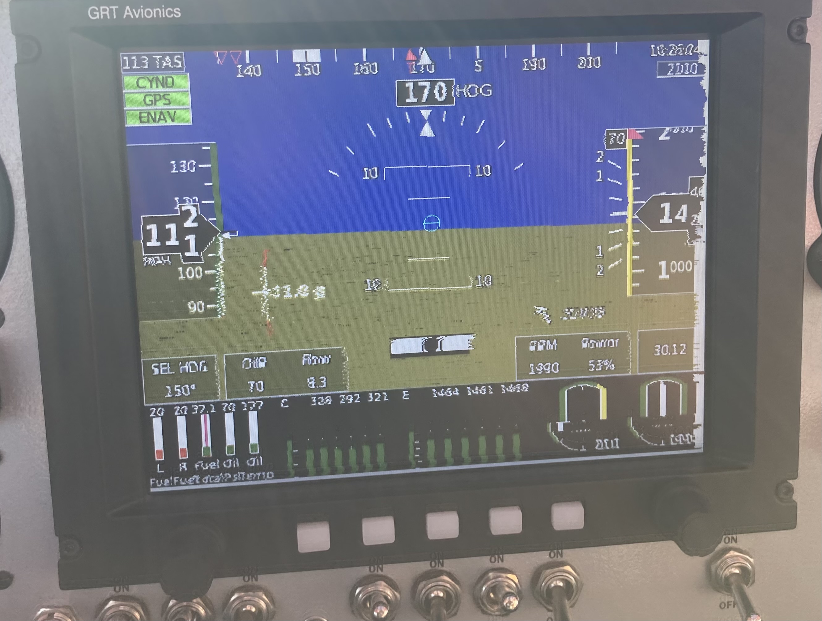

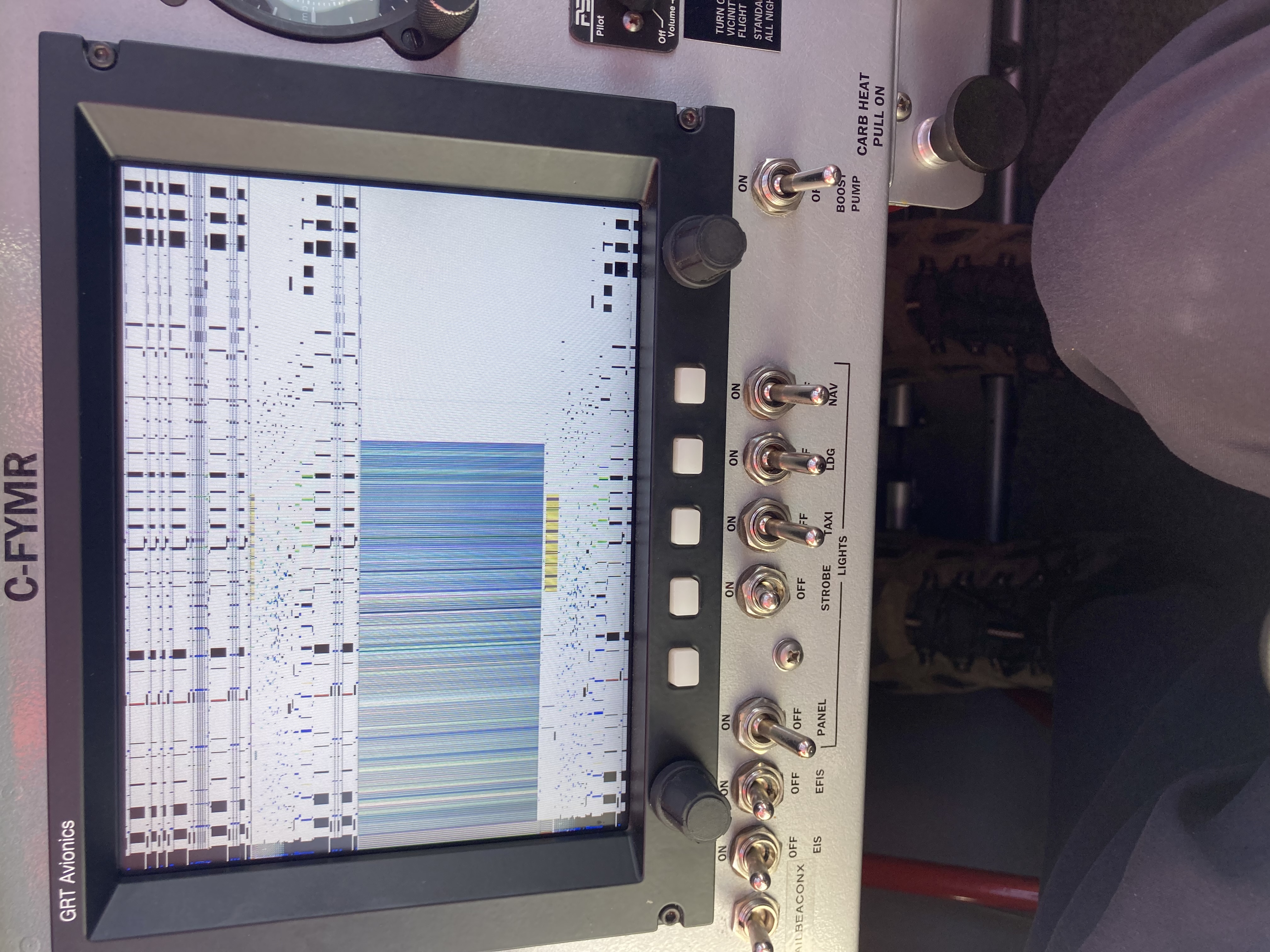

My Sport SX (2016 unit) display started flickering couple mouths ago. The graphics look also smeared. It came and go. But last week, the display went almost fully white, and it’s now a permanent state.
Couple weeks ago, pushing on the lower bezel solved temporary the flickering problem.
Any one else had that problem before.
I’ll try to post few images if I can.

That's a video signal issue and we can still fix that on the SX models. It has to do with the video cable and connection. You can send it to GRT with a copy of the Service Request Form inside the box to get it fixed. Get the form from our Support page:
https://grtavionics.com/tech-support/
