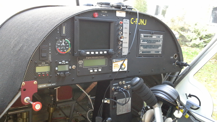

Now that I have started actually flying my new build (Zenith CH-750, C-FJNJ), I have started to explore my Sport SX. I do have the latest software (9d), but so far haven't found the snapshot button. Also, is it possible to import user waypoints into the user waypoint database via a file on the USB drive, maybe in CSV format? Most of my flying is from/to private grass strips, and I have collected several dozen waypoints that I would like to get into my EFIS. Surely more question to follow, but that's it for now... thanks!
J.
My panel
My panel
