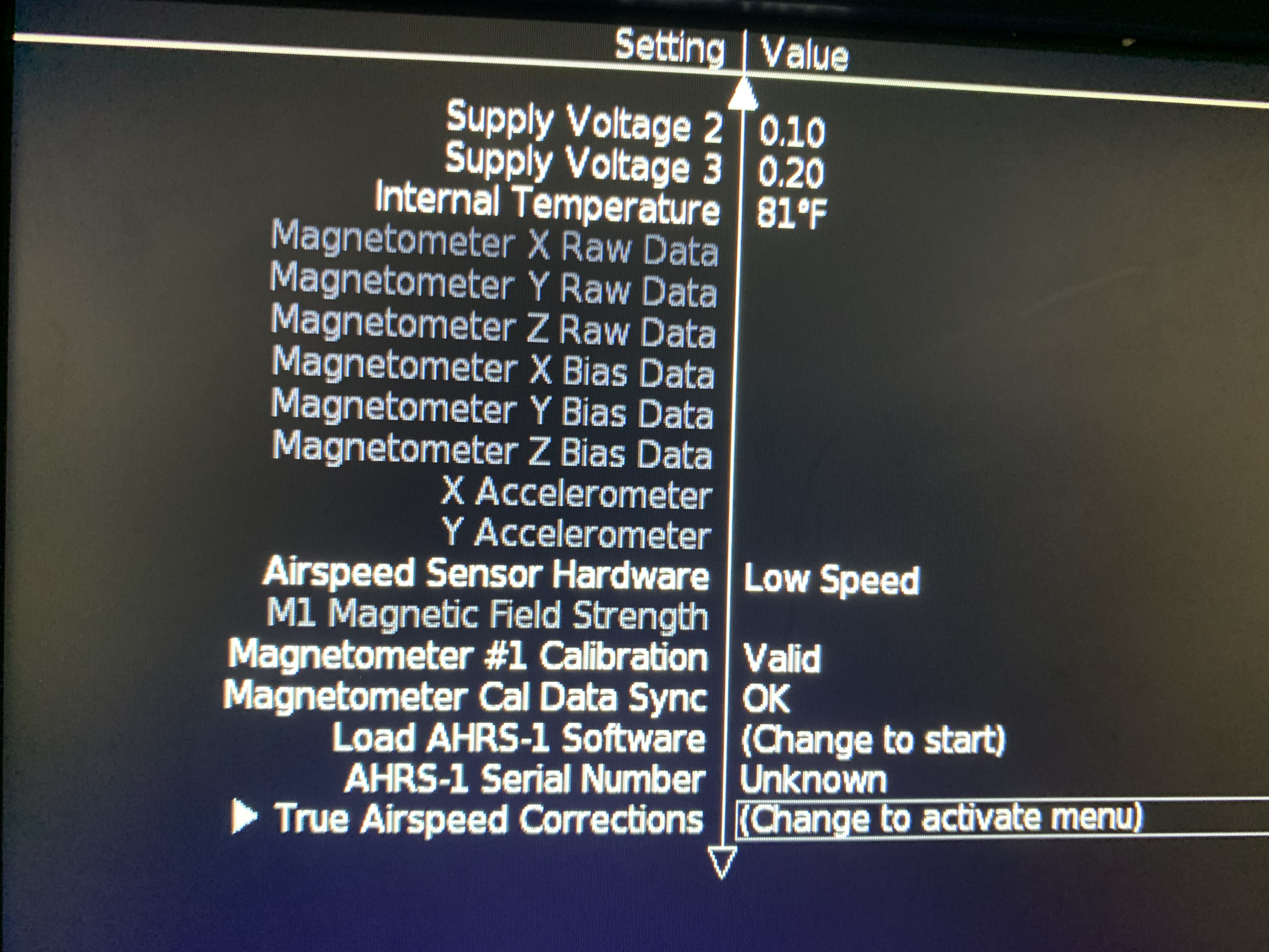

Jeff are these the values of which you speak?

Yes, all of your Magnetometer Raw/Bias Data and X/Y Accelerometer lines are blank. That means the AHRS isn't getting the commands from the EFIS to turn them on. That could mean the serial output isn't configured on the correct display or port or there's a problem with the wire. One screen should have a wire from a serial output (the same port number as the input) going to the serial in on the AHRS (AHRS pin 5). This output would be configured the same as the input (AHRS-1/Air Data Computer #1).
In a typical HX installation, Serial Port 2 would look like this:
Serial Port 2 Rate: 19200
Serial Port 2 Input: AHRS-1/Air Data Computer #1
Serial Port 2 Output: AHRS-1/Air Data Computer #1
The AHRS could be wired to another port though, especially if this was an upgrade from an older system. If the AHRS is wired to port 2, then that would mean the output is HX pin A4 and that would go to the AHRS pin 5.

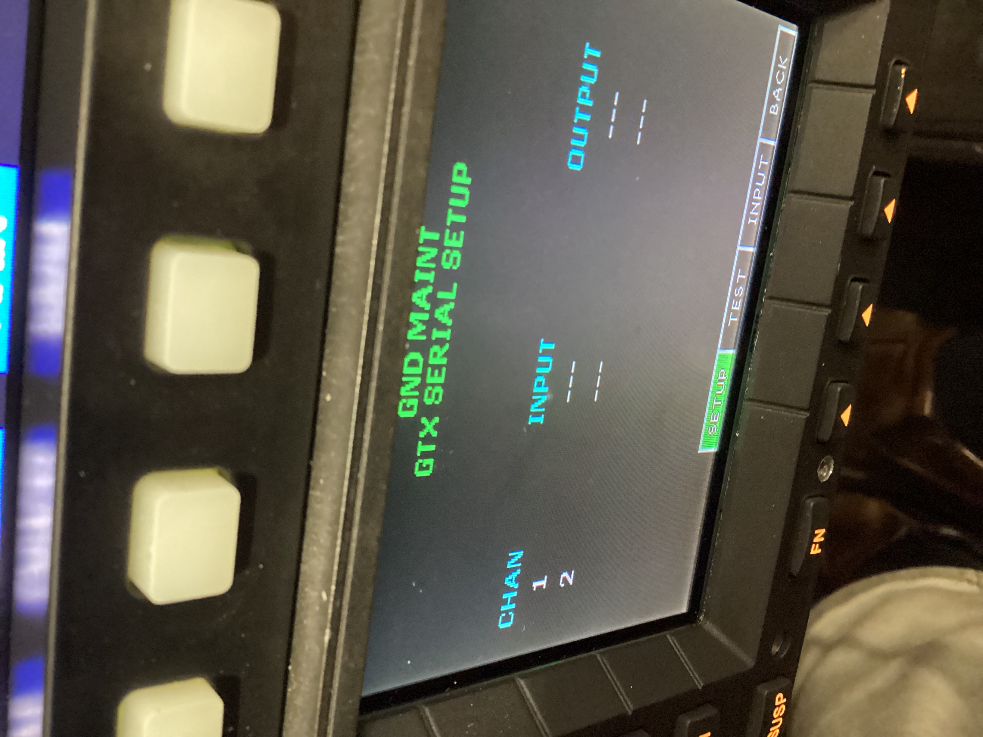

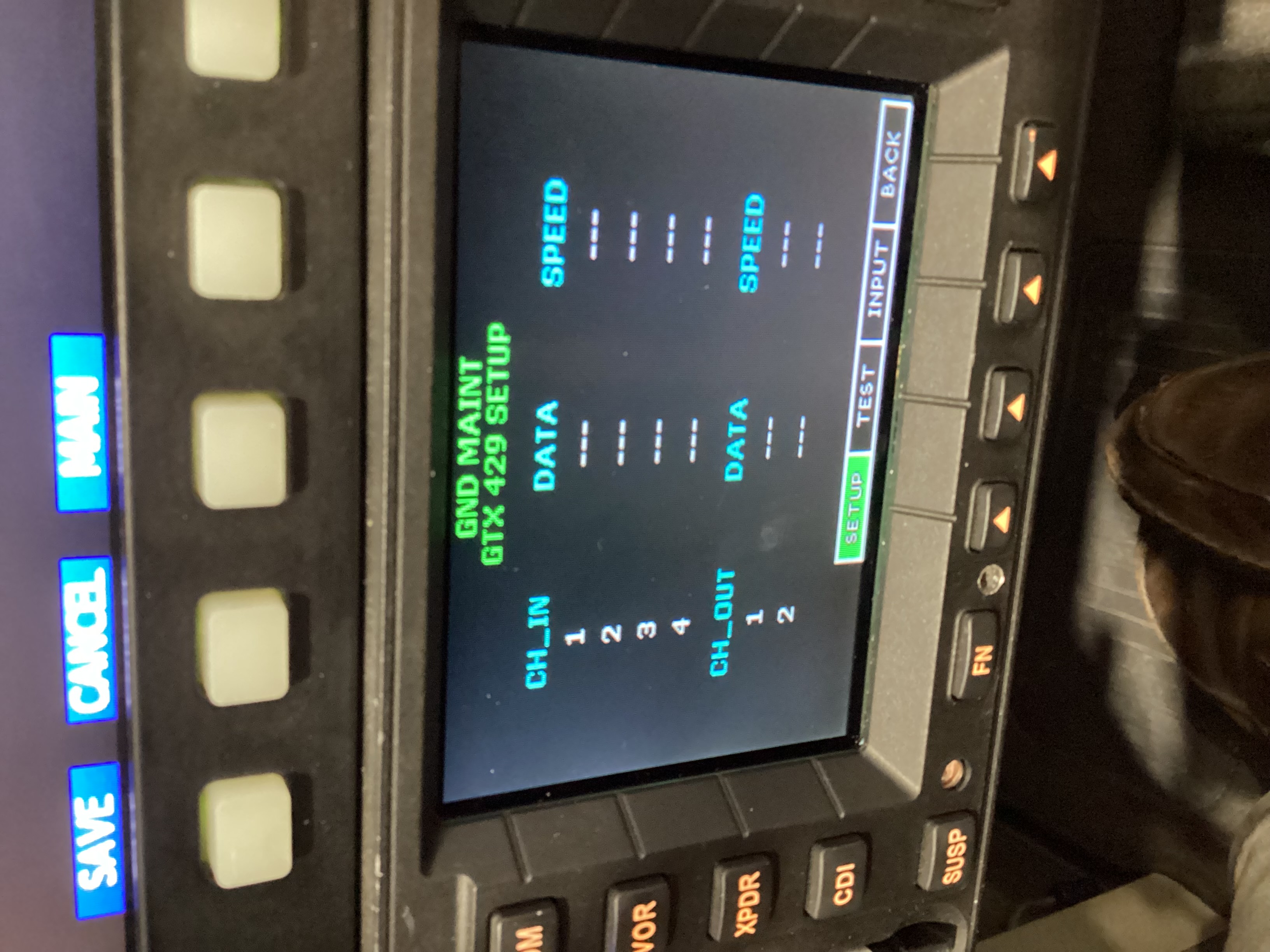

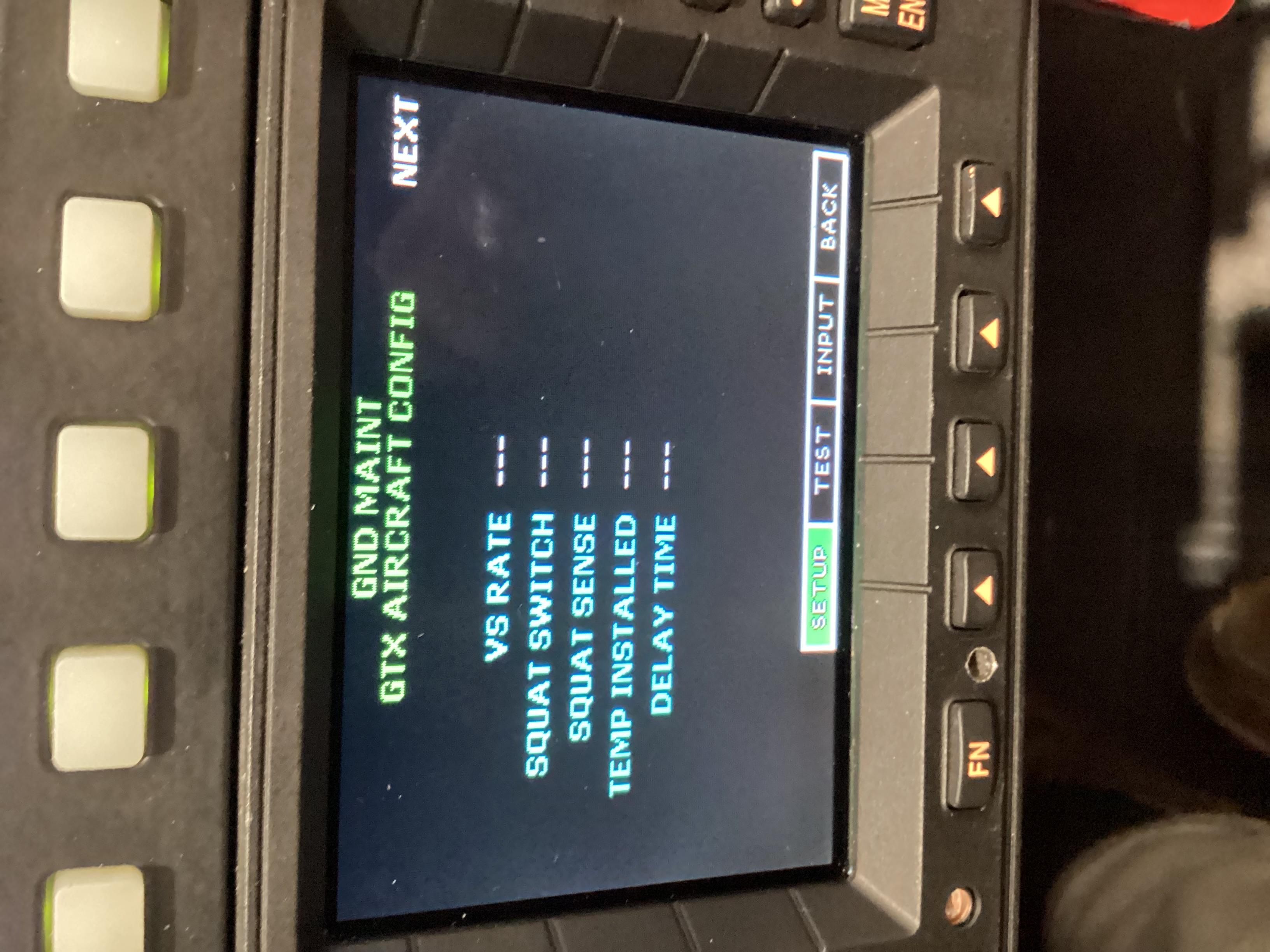

Again thank you Jeff, I made the configuration changes you suggested and got my AHRS unit working correctly. Now I have another issue which may not be appropriate for this forum but you have by far been the most helpful in terms of sorting out my configuration issues. The problem I am having is with my legacy equipment. My Garmin GNS480 is not communicating with my Garmin GTX33ES transponder and I’m at a loss as to why. The configuration screens on my GNS480 which control my transponder in these photos will not allow me to make any changes.

The manual says you can't make any changes if they aren't communicating. That would involve the configuration on the 480 serial port 6 and the wiring from the 480 port 6 to the GTX33 port 1. We don't know any more than that.
