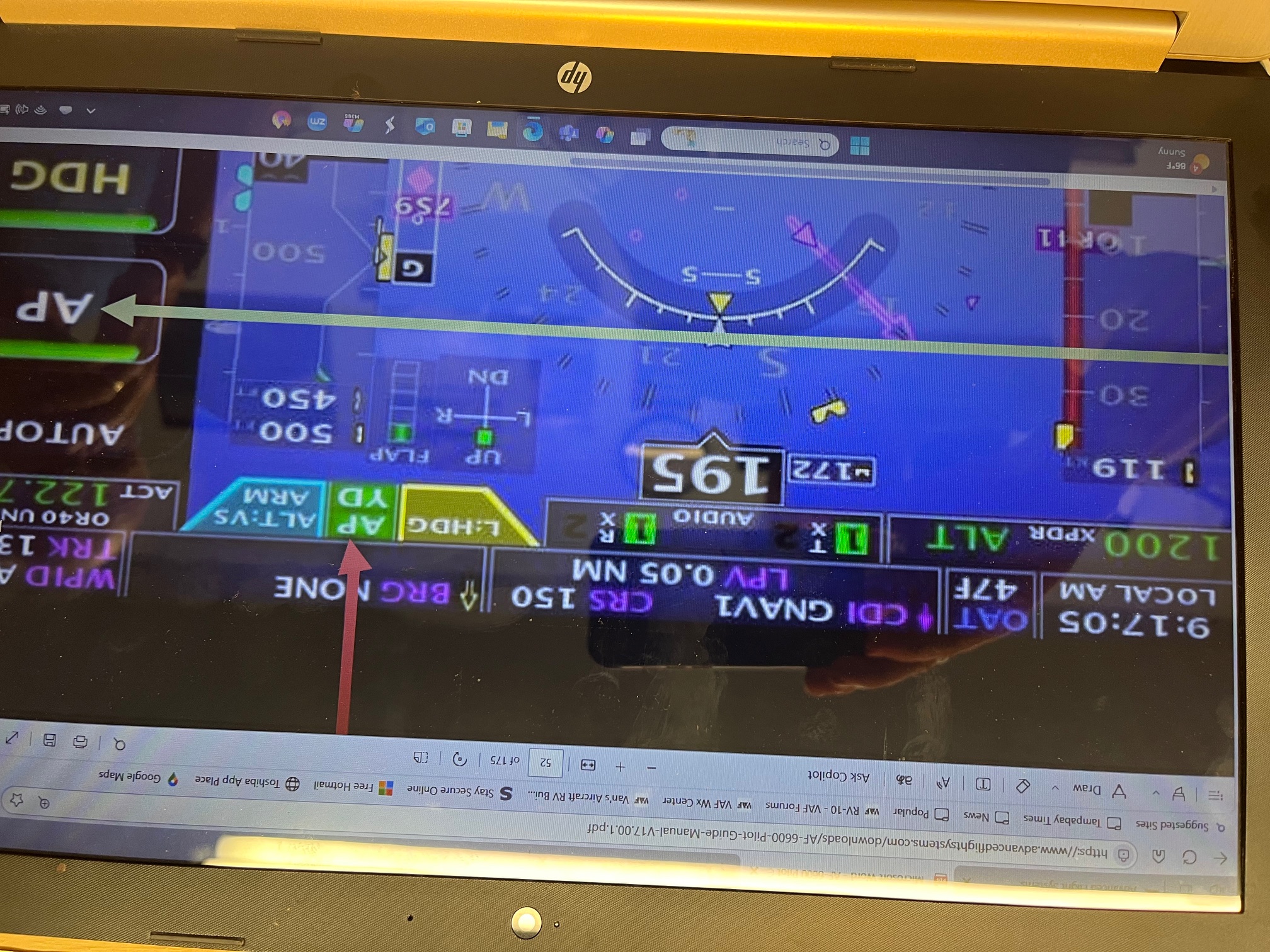

Not trying to be a pest I promise! Attached is the screen from a friend's Advance screen. His GPS is a 650. It appears to have the LPV label on the screen during the approach he was flying. This would be a nice feature if at all feasible.

Re: Display of GPS approach type
I found it in the ARINC 429 GAMA data. It has the ability to say LNAV, LNAV/VNAV, LP, and LPV. We'll have to figure out what we're going to show and where.
