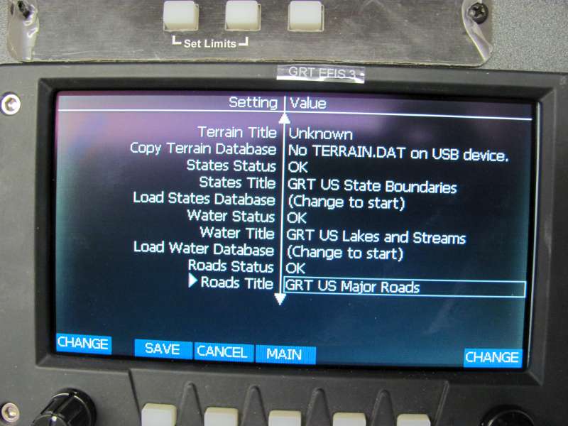

That procedure worked perfectly. I was able to update the EFIS software, add the Nav.db but not the Terrain.db software. I tried two different USB drives (including the one supplied by GRT) and downloaded the Terrain DB twice. I get the message the system could not find the file terrain.db on the USB drive. I verified is was there on all attempts to load but no luck. Strangely, I was able to load the other db's such as Roads, Lakes, etc.. Any ideas what I am doing wrong with the Terrain db.?
As I went to load a picture showing the screen I noticed that the downloaded database is called terrain48.dat and the system is looking for a file terrain.dat. Should I rename the terrain48.dat to terrain.dat?
Rocky Morrison
Rocky Morrison
- WS terrain db won't load
- IMG_4662-800.jpg (54.84 KiB) Viewed 28641 times
ZuluZephyr

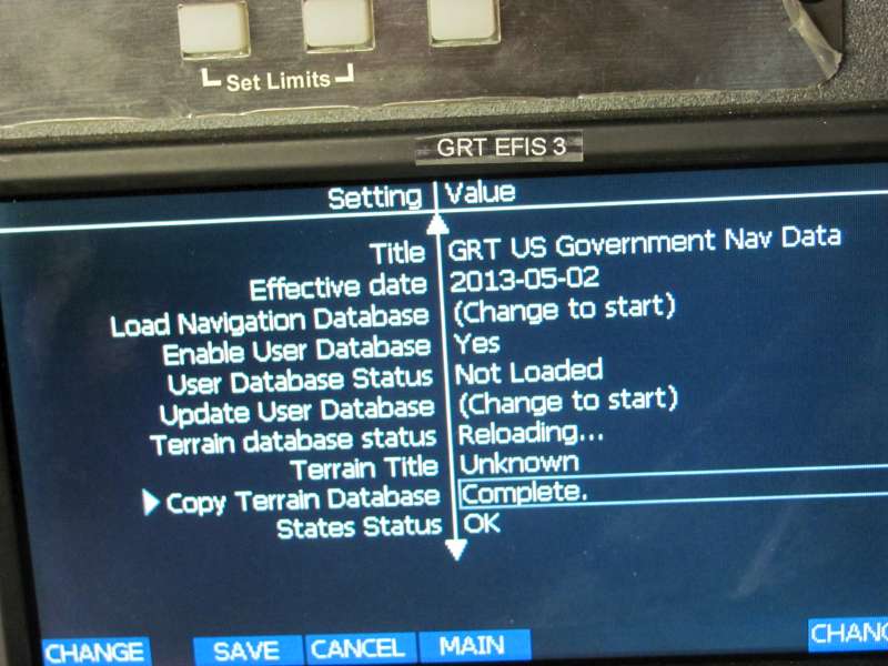

Renaming the file did allow the file to load but did not bring up the terrain database. The file did not come up with a name and it stayed in the "reloading" cycle and never exited.
Attached is a screen shot.
Let me know what to try next.
Rocky Morrison
Rocky Morrison
- Screen shot of WS with renamed terrain db
- IMG_4669-800.jpg (56.94 KiB) Viewed 28630 times
Re: Upgrading Software HS
If the terrain database details never come up, check the Terrain setting in the SET MENU, Moving Map. It has to be turned on there or the EFIS will ignore the data. If you have to turn it on, SAVE before checking again.

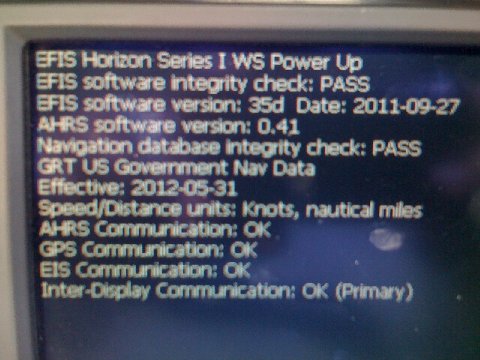

I have a dual WS EFIS display in my RV-8. The EFIS version is 35d dated 2011-09-27. The AHRS version is 0.41. I assume there are later versions of both. I saw the reply to ZuluZephyr and assume the download process will be the same for me. When I tried to update with a new flash drive, we got the message "need CHECKSUM". I extracted the zip file and moved the separate items into my flash drive. Is that the correct procedure?
In addition, can I load the NAV update and Terrain update on the same flash drive?
- EFIS screen
- IMG_0299.JPG (40.92 KiB) Viewed 28571 times
Sorry I missed your reply. Yes, your update procedure would be the same. All of the same models use the same update procedure. The zip extraction program often lets you select the directory to extract to. You may need to change this to the drive only. For example, it might say "E:\Full vxx xxxx-xx-xx" for the destination. You may need to change that to "E:\" for the EFIS to find it. As an alternative, you can extract the files anywhere, select all of the files and folders, then copy them to the flash drive. In any case, make sure you maintain what files are inside and outside of the CHECKSUM folder. They have the same names, but they contain different information.
You can put any other updates on the same flash drive. There are no changes to the terrain, though. The terrain source data does not change often. If you already have the terrain data you want in your display, you don't need to reload it.
