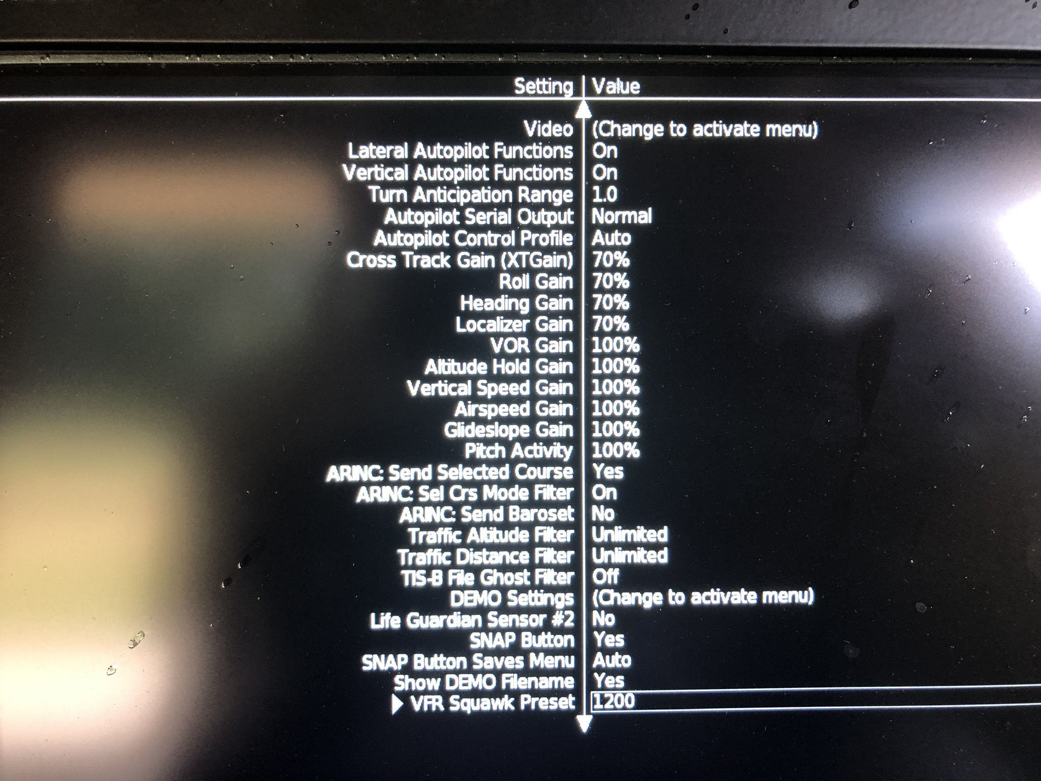

Re: When HX (now HXr) is driving TT AP it constantly wing ro
The HXr and HX have the same autopilot software. Did you upgrade your AHRS at the same time? That could change the dynamics. The HXr may run slightly slower because it has a higher resolution and more complicated PFD page, but that shouldn't have a major effect on the autopilot.
Your settings are saved in a DEMO recording. There is no way to view or print settings from a backup or DEMO besides restoring the backup or playing the demo on a display unit.
There's no way to partially reset some settings. The autopilot settings for a non-GRT autopilot are mainly the gains in General Setup. All of the gains start at 100%. The Autopilot Control Profile should be Auto (or Other). The Autopilot Serial Output should be Normal.

Here is a photo of the AP setting in the Main Menu.
Autopilot Settings in Main Menu
Jeff, based on your note, the only thing different than the defaults are 4 gain settiing set at 70%. I’ll change them to 100% for the next flight.
Any other suggestions?
