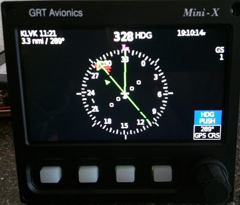

A couple questions I can't find answers to in the documentation:
What is the Green "1139" number shown below at the 10 degree nose down line?
Also, how do you get the mini to show flight director bars? Are they driven by another GRT unit somehow?
2015-05-07 12.10.15.jpg (47.01 KiB) Viewed 27506 times
Also, in HSI mode how do you adjust the course arrow direction, so you can proceed inbound to a waypoint from a different direction other than direct at the time of entry? On my mini shown above on my test bench, spinning the course knob does nothing. I am however able to set the heading bug like you said in a previous post.
Thanks in advance for your answers, I look forward to getting this unit up and flying.

I can answer some questions, assuming the mini software is like the HX:
Green numbers are height AGL, calculated from terrain database and gps data (need both working). Should read zero as you land.
Choice of conventional AI display or Flight Director inverted V display is an option found in the autopilot menu, should work regardless of whether or not you have an autopilot installed.
HSI pointer, this is more complicated:
If the data source is a localizer, it should be on the runway heading or 180 off for backcourse (if you do not use the BC menu option).
If data source is a VOR, you should be able to adjust the pointer. Some VOR boxes (430) require an ARINC connection for this, some (SL30) do not.
If data source is a gps, the GPS is always locked onto a 'TO' the waypoint, so HSI pointer is not adjustable, unless you have a ifr-TSO'd gps like a 430. If so, push 'OBS' on the 430; the gps now acts like a VOR located at the gps waypoint, and the HSI pointer should be adjustable. Again you need an ARINC connection for this to work, I think.

The number under the flight path marker with SAP activated is the altimeter height above the selected runway. If your altimeter setting is correct, it should read around zero when you touch down.
The GPS course is locked unless you are in a GPS HOLD mode. If you are flying with an external GPS like a 430W, the course knob will work when the GPS indicates it's in a sequence-hold mode. For the internal flight plan, it appears we are missing the GPS SEQ button on the Mini. I'll look into that.

Thanks for the answers guys.
Based on that, I am assuming that I since I have the mini-x not mini-ap then I don't have an autopilot menu and thus no FD bars.
Regarding the GPS course being locked on the HSI map display page, hopefully that will be something that you guys will update. Having an HSI display that allows us to change the inbound or outbound course to/from ANY active waypoint would allow function as expected by most pilots and be pretty useful at times.
