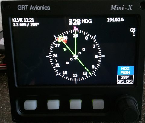

Yes-- the HSI can show magnetic heading and an actual heading bug if your Mini X is equipped with the external magnetometer. The screenshot below was recorded on a unit that does not have a remote magnetometer, so it's in Track mode-- but it shows the HSI screen with the knob in heading select mode. The current software for the HSI defaults to Course Select, but if you press the knob once, it enters Heading Select mode. You can leave the HSI in that mode for as long as you want-- as long as you don't press the knob again or exit the screen, the HDG bug can be adjusted directly from there.

Also, in HSI mode how do you adjust the course arrow direction, so you can proceed inbound to a waypoint from a different direction other than direct at the time of entry? On my mini shown above on my test bench, spinning the course knob does nothing. I am however able to set the heading bug like you said in a previous post.

HSI pointer, this is more complicated:
If the data source is a localizer, it should be on the runway heading or 180 off for backcourse (if you do not use the BC menu option).
If data source is a VOR, you should be able to adjust the pointer. Some VOR boxes (430) require an ARINC connection for this, some (SL30) do not.
If data source is a gps, the GPS is always locked onto a 'TO' the waypoint, so HSI pointer is not adjustable, unless you have a ifr-TSO'd gps like a 430. If so, push 'OBS' on the 430; the gps now acts like a VOR located at the gps waypoint, and the HSI pointer should be adjustable. Again you need an ARINC connection for this to work, I think.
Re: Some Mini-X Screenshots
Posted: Fri May 08, 2015 3:22 am
by GRT_Jeff
The number under the flight path marker with SAP activated is the altimeter height above the selected runway. If your altimeter setting is correct, it should read around zero when you touch down.
The GPS course is locked unless you are in a GPS HOLD mode. If you are flying with an external GPS like a 430W, the course knob will work when the GPS indicates it's in a sequence-hold mode. For the internal flight plan, it appears we are missing the GPS SEQ button on the Mini. I'll look into that.

Regarding the GPS course being locked on the HSI map display page, hopefully that will be something that you guys will update. Having an HSI display that allows us to change the inbound or outbound course to/from ANY active waypoint would allow function as expected by most pilots and be pretty useful at times.
