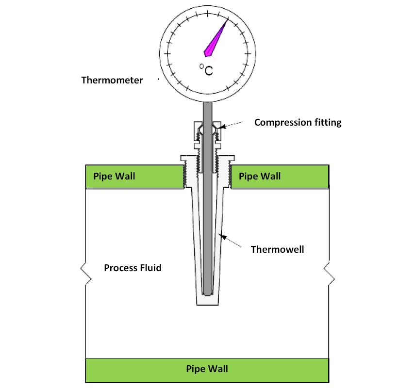

To help with the direct heat, I was thinking of adding Thermowells.
Yes it will have a longer response time, but with a Rotary engine producing very hot exhaust, this might be a way to extend their life.
A Thermowell.jpg (39.38 KiB) Viewed 19889 times
