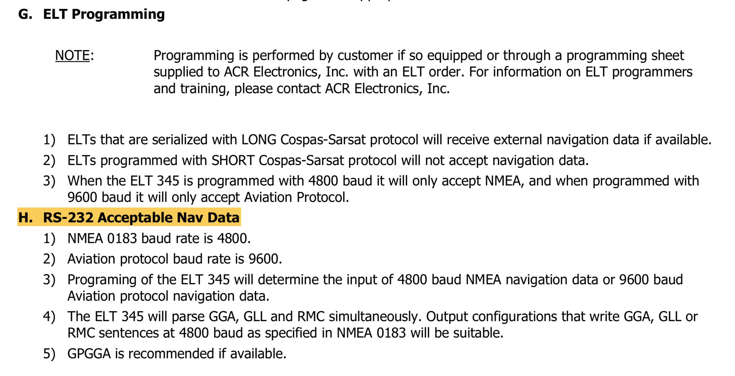

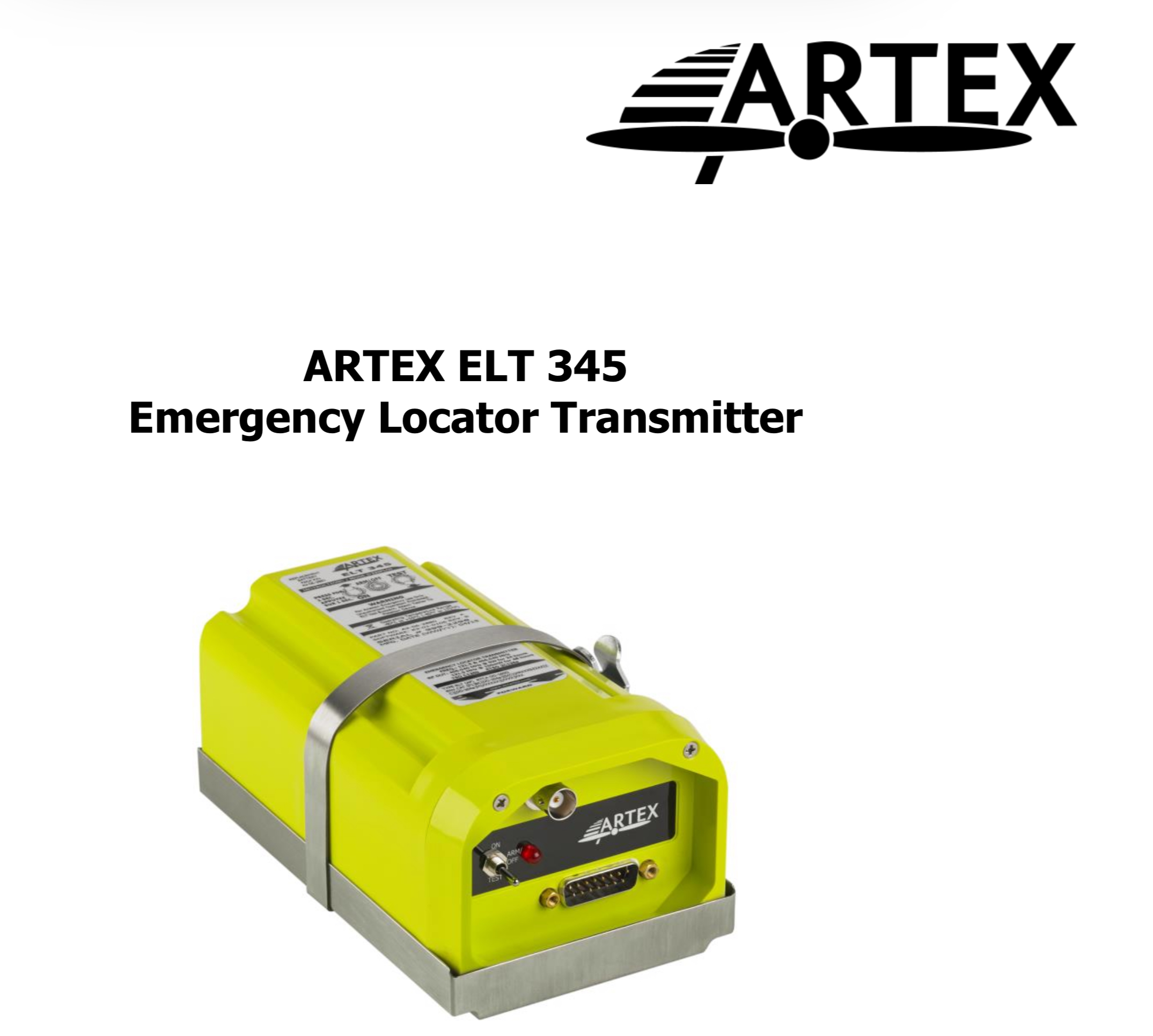

As part of my panel/aircraft upgrades, I am also installing an ELT (ARTEX ELT-345) and would like to understand what capabilities the HXr has for displaying info and functionality with this.
In the ARTEX manual it states baud rates based on different setups (I have attached a screenshot from the installation manual) and would like to know:
1. HXr Capabililties with this ELT (aka what can it do from an interaction and display standpoint)
2. Verify which Serial naming and baud settings are correct.

An EFIS serial output can be programmed to output "Autopilot (NMEA0183)" data at 4800 baud or "Autopilot (Aviation)" data at 9600 baud. You can only have one of these outputs per EFIS display so if you are already using it you may need to splice wires. If you have our Safe-Fly GPS, then another option is to configure it to output Safe-Fly NMEA0183 at 4800. The ELT has to be programmed to accept one of these.
There is no other interaction between the ELT and the EFIS. The EFIS can't report any status information or command any tests.

I just learned from ARTEX that they program all of them with the "Aviation" format (not the NMEA0183) and will need the 9600 Baud Rate.
If I want to use the NMEA0183 it would require me sending it in to a 3rd party (like Dallas Avionics, etc) for "reprogramming" which I would like to very much avoid.
Based on this and your earlier reply, this negates the capability of using those SPC ports right? As they are all NMEA0183 and do not offer the other Aviation Protocol?

You would have to use the "Autopilot (Aviation)" output. You can use one of the SPC ports for this output but it won't be sent directly by the Safe-Fly so there's no reason to do that unless you're out of ports on the HXr. The EFIS would send the Autopilot Aviation data to the Safe-Fly and the Safe-Fly would relay this to the SPC port.
